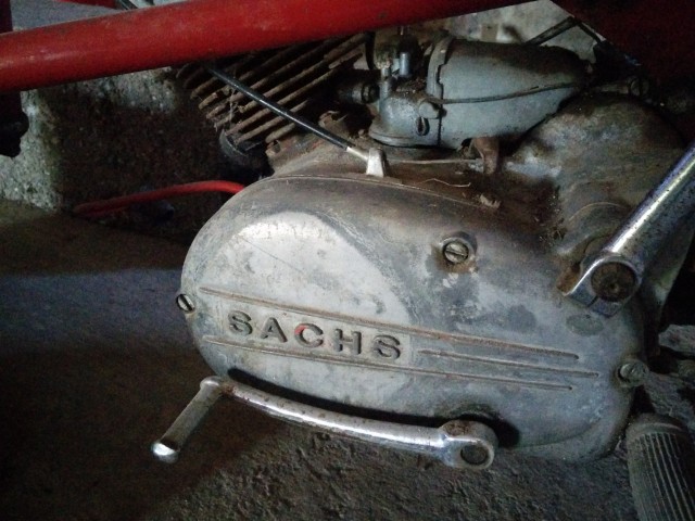

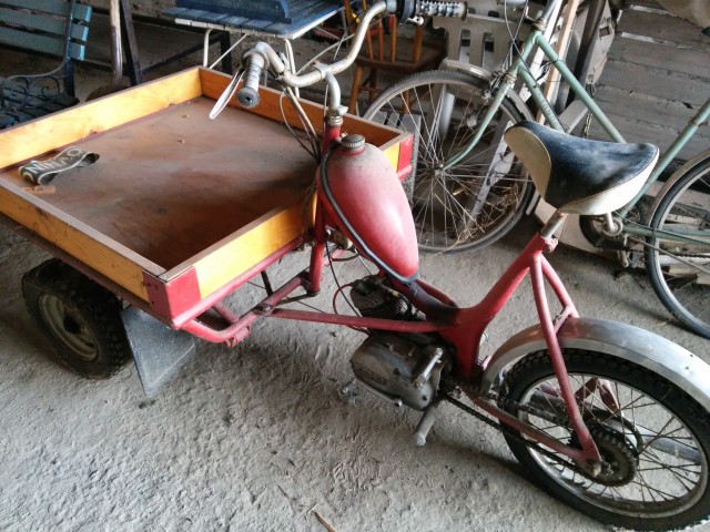

I recently became the owner of a flakmoped and have begun the exciting restoration work! After a lot of googling I am slowly beginning to suspect that I have some kind of hybrid and this is where I'm hoping the forums expertise can help.

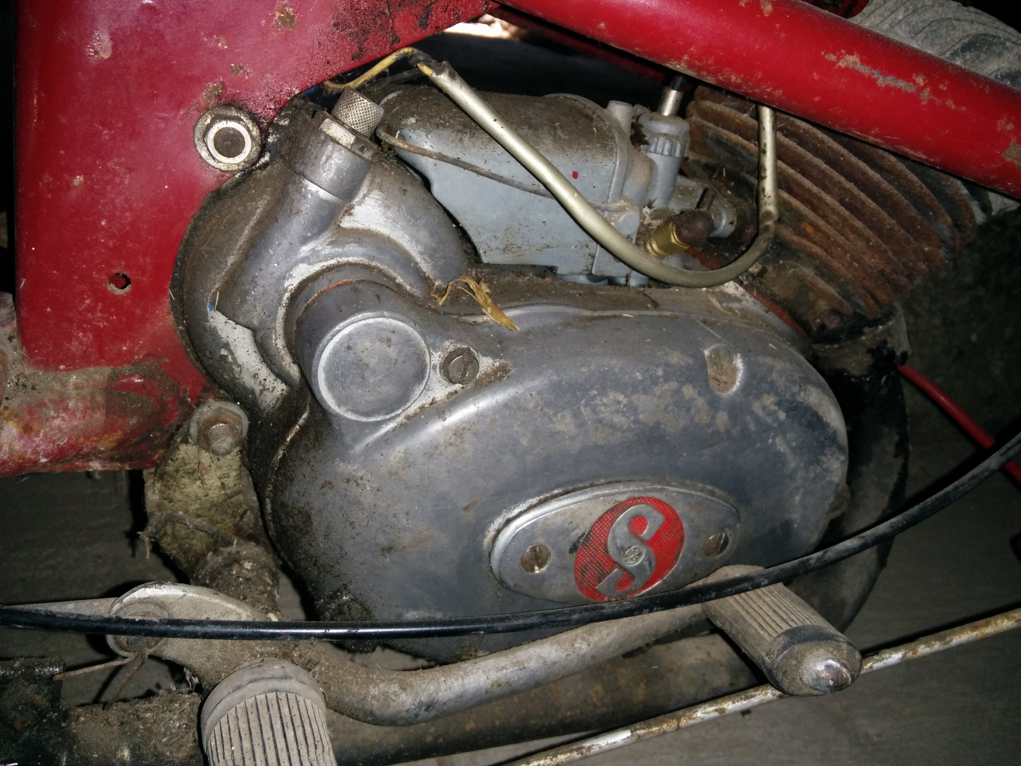

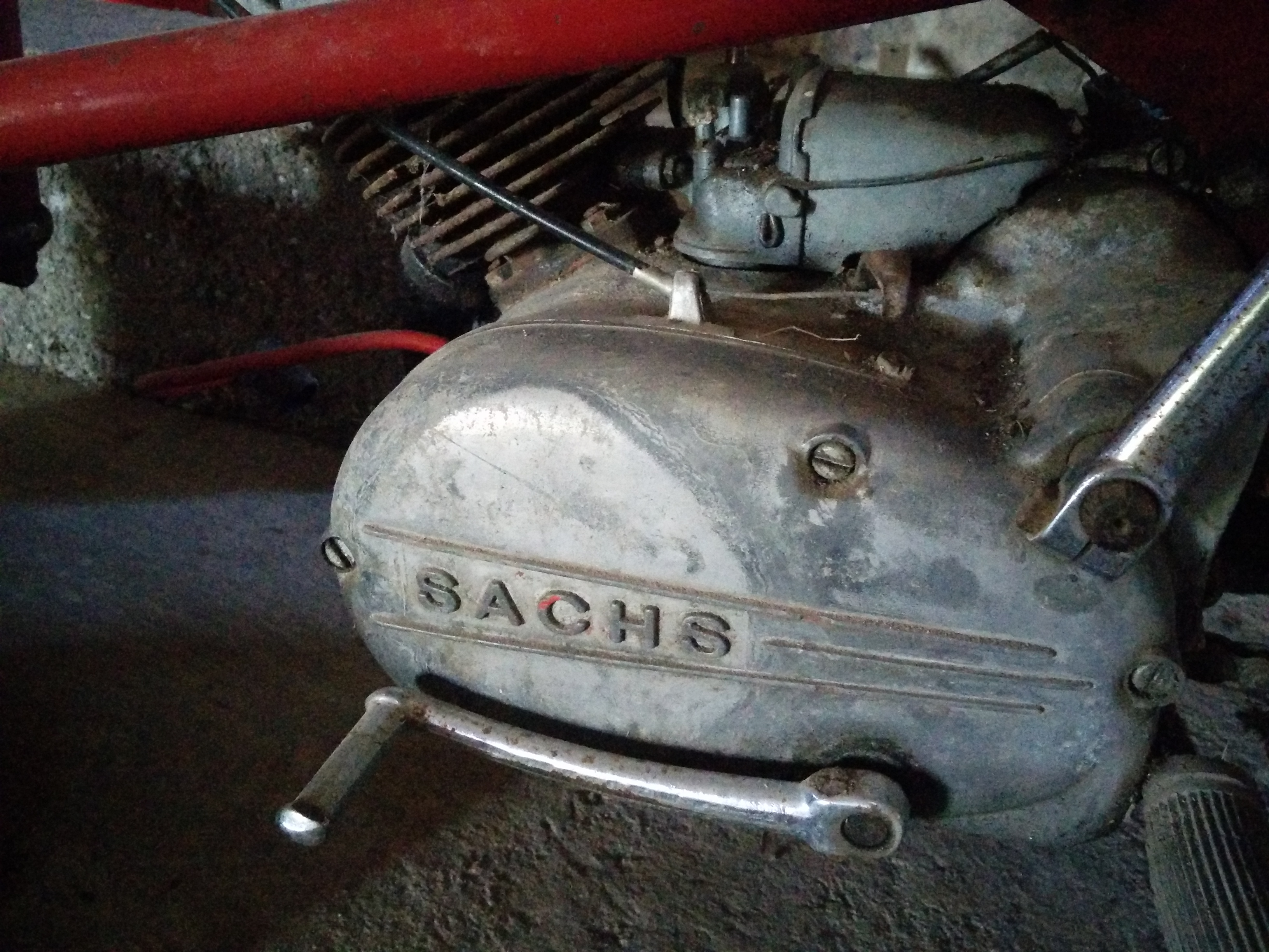

The actual flakmoped itself looks like an MCB 1189 (it also came with an instruction book for the MCB 1189 (1194, 1199, 1199-1)). But as far as I can tell, those models were only shipped with the Sachs 50/3 LS, which is fan cooled, handgear motor. The motor which is installed, based on my relatively basic knowledge, appears to be air cooled, kick start and have a foot transmission. I believe I have identified the motor as a Sachs 50/3 KFS (it has lost its identifying plate).
As I don't want to order incorrect replacement parts, could anyone take a stab at proving or disproving my motor guess and offering suggestions as to which flakmoped model it is? Failing that, any tips on how I can visually narrow down the options would also be appreciated?

Denna är nog en äldre modell än 1189, svårt att se men det verkar sitta de äldre naven med kulringar fram.
Bakskärm och bakhjul är Mustang mamba
Om motorn har varit fläktkyld tre v fot försvann typskylten med den kåpan, ser inga hål för typskylt så det är nog så
Titta efter på höger motorhalva strax under cylinder nyare har ett motornummer där.
Styre & styrstam är vanliga cykeldelar
